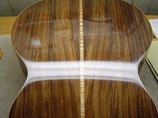

First of all, French Polish is a technique not a finish and this technique implies a gloss sheen. It sounds to me all you want is a shellac finish with a matte sheen. This is easily achieved by applying shellac, either by brush, spray or pad and then using oooo steel wool and a bit of wax to rub it down to a matte finish. I actually show how to apply this finish and rub it out on my guitar finishing dvd which should be released in a couple of months.
Here is what the results look like.

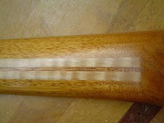

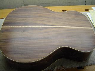

Here is the same rubbing out technique but this time on lacquer. One shot shows the high gloss and the other shows after being rubbed out with steel wool and wax.
